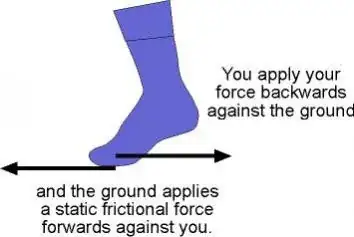

Take for example, the simple process of walking.
You push the ground backwards ("action" force), the ground pushes you forward ("reaction" force). It is clear that they are not acting on the same object. And hence, they obviously don't cancel. Otherwise you wouldn't be able to walk.
To avoid possible copyright issues, I point out at the original source of the image is this.
