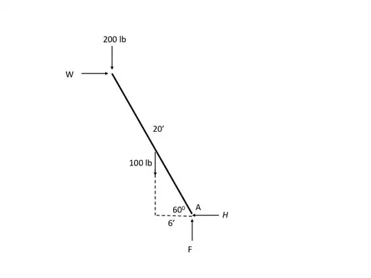

As in, why would H = W?
You need to look at a free body diagram of the ladder. See figure below. The free body diagram shows all the external forces acting on the ladder. As you can see, there are only two horizontal forces acting on the ladder, the reaction of the wall, $W$ and the friction force on the floor, $H$. In order for the ladder to be in equilibrium, the sum of the horizontal forces must be zero. Therefore, $H= W$.
Hope this helps. enter image description here
