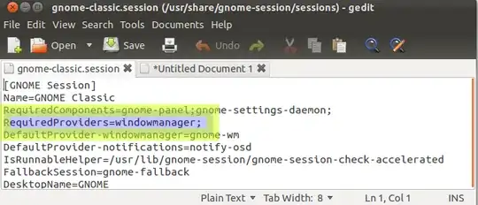

gksudo gedit /usr/share/gnome-session/sessions/gnome-classic.session
Now edit the file shown to contain this line entry:

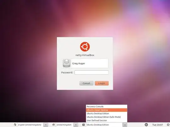

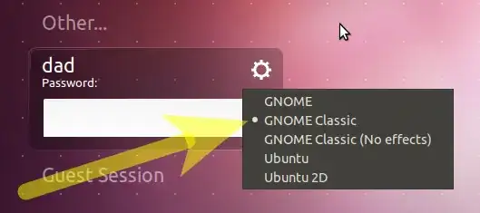

How to login to Gnome-Classic
Save, logout and in your session options choose Gnome Classic

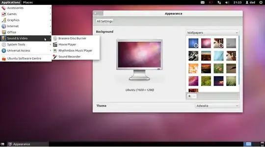

Changing the theme
You'll notice that the default Ubuntu Ambiance theme doesn't look great in Gnome Classic. We can correct this by changing to a Gnome 3 friendly theme.
... and choosing Appearance enter image description here
Change the theme to Adwaita... enter image description here
Note - see the linked questions below for other theming options.

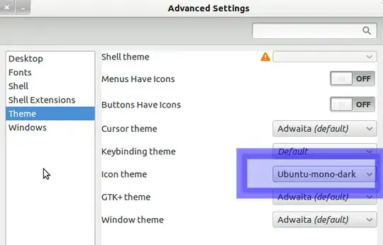

Changing Icons
Launch gnome-tweak-tool via the menu option:
  • Applications --> Other --> Advanced Settings
Change the icon theme as shown:

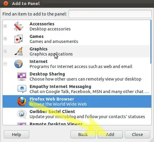

Restructure the desktop layout
Now lets get back the panels to something that we are familiar with...

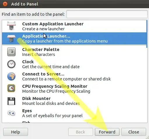

Press Alt+Win and right-click the top menu bar - N.B. Win is the Windows Symbol key
(If you are using Gnome Classic (No Effects) i.e. gnome fallback mode then to add to the panel use Alt and right-click)
Choose Add to Panel
Click the option shown and click the button Forward

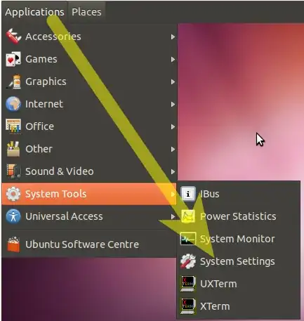

Now we need to change the number of workspaces back to two.
Navigate to Applications - Other - CompizConfig Settings Manager - General Options - Desktop Size and change the Vertical Virtual Size value to 1

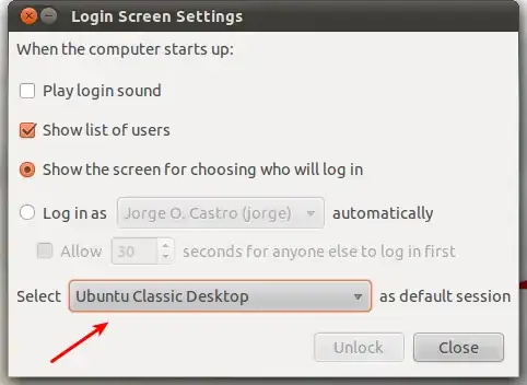

For 11.04
  1. Log in with the classic GNOME session by selecting your username and then selecting Ubuntu Classic:
    Screenshot 2
From then on GDM will remember your setting. To permanently make the Classic Session be the default, run the Login Settings tool and select the classic desktop:
Jorge Castro
Choose Add to Panel
Launch MyUnity via its icon in System Settings

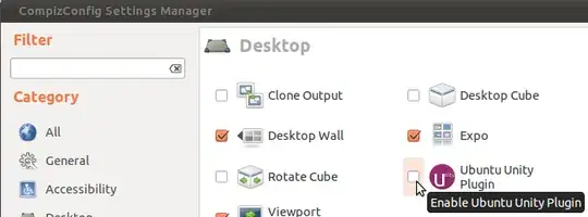

  • start ccsm
    ccsm
  • disable Unity plugin

After it is done install, change the Theme to Ambiance.
This is how It is going to look like

To switch which one you use, just hit the little gear icon above your password field on the login screen.
