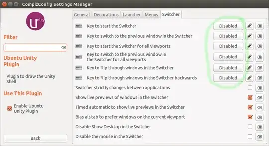

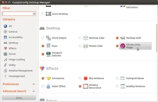

  4. Disable the keyboard shortcuts for Unity's switcher by unchecking CompizConfig Settings Manager ▸ Desktop ▸ Ubuntu Unity Plugin ▸ Switcher ▸ Key to start the switcher ▸ Enabled and Key to start the switcher in reverse ▸ Enabled

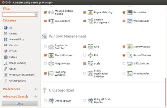

  5. Enable the Static Application Switcher by checking CompizConfig Settings Manager ▸ Window Management ▸ Static Application Switcher ▸ Enable Static Application Switcher

You should install CompizConfig Settings Manager. From there you can find the Unity plugin
and disable the switcher, by clicking on each of the key bindings and unchecking 'Enabled'
Then you can enable one of the other window-switcher plugins under Window Management.

  1. Start CompizConfig Manager by typing ccsm in terminal (thanks to @donbright) or find it in the Dash.
  2. In CompizConfig Settings Manager, navigate to Desktop ▸ Ubuntu Unity Plugin ▸ Switcher Disable ALL the keyboard shortcuts. It should look like this on Ubuntu 15.04 when you're done:
Disable all keyboard shortcuts in the Unity Plugin

  2. Enable the Static Application Switcher by checking Window Management ▸ Static Application Switcher ▸ Enable Static Application Switcher. Things may flicker for a few seconds. If you get warnings, don't ignore them; go back and fix your mistakes. Success looks like this on Ubuntu 15.04:
