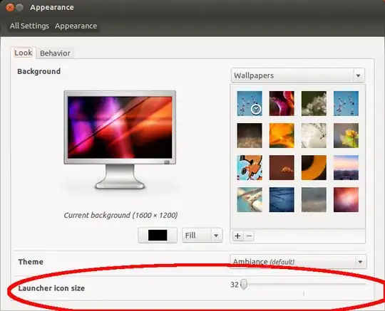

My problem though is that I can not find any setting that control the launcher. The quide says in settings appearance there should be a slider that controls the size of the icons. I can not find it. I don't know if my theme makes it invisible? Can someone help I can't find it.

When you open the appearance settings the slider is at the bottom.enter image description here
