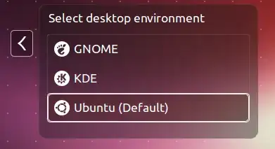

Run the command
sudo apt-get install lubuntu-desktop
then at login click the little ubuntu icon next to your name. It'll take you to a menu like this: desktop-environments
Click LXDE.
