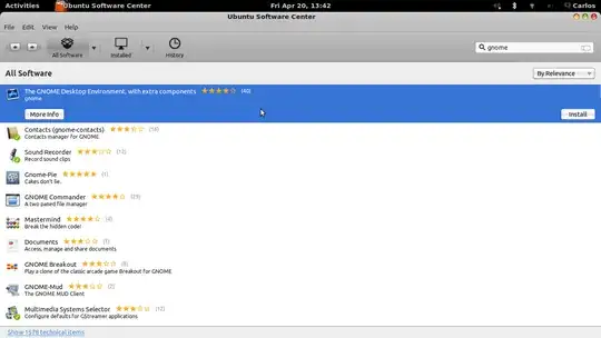

Go to software center and install the gnome package. Gnome package in ubuntu software center Then, when you log in, in the right above of your pasword box there's a icon of ubuntu. Click and select gnome(classic) and you log in in the classic gnome desktop.
