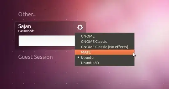

Log out and choose MATE from your login menu
Mate login
