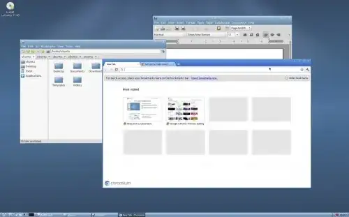

I really like the simple look of Debian's interface. What desktop environment is it? Is it easy to replicate?

That screenshot is gnome 2 on Debian and although you can make Ubuntu look somewhat like gnome 2, you can not run gnome 2 on Ubuntu.

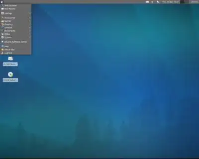

You might be interested in an alternate window manager such as xubuntu or lubuntu (or Fluxbox)
Xubuntu
Xubuntu
Lubuntu
Lubuntu
