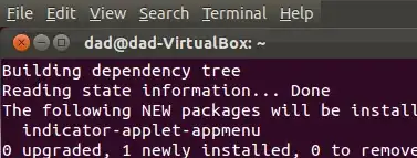

Now install the applet you want to add to the panel:
1) The whole indicator applet:
sudo apt-get install indicator-applet-complete
2) Unity Global Menu type applet:
sudo apt-get install indicator-applet-appmenu
3) Session applet:
sudo apt-get install indicator-applet-session
4) Standard applet:

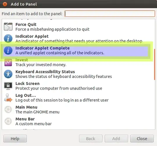

To add to the panel:
Win+Alt+Right click the panel if using Gnome-Classic or Alt+Right click the panel if using Gnome-Classic (No Effects)
Choose Add To Panel and add the following indicator
You can tidy up by removing the old notification area.
The end-result could look like this:
