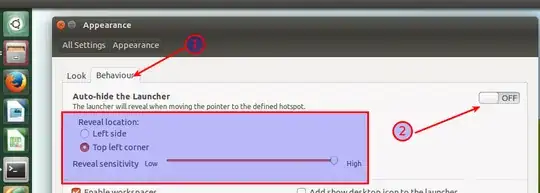

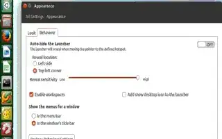

12.04 and later
From the Gear, choose System Settings
Double click the Appearance icon
Click the behaviour tab and then toggle the autohide option...
You can re-reveal the menu by pushing onto the left-hand side of the window or the top corner depending upon which option is shown as per the picture.

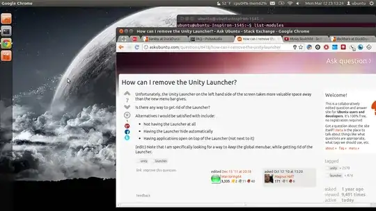

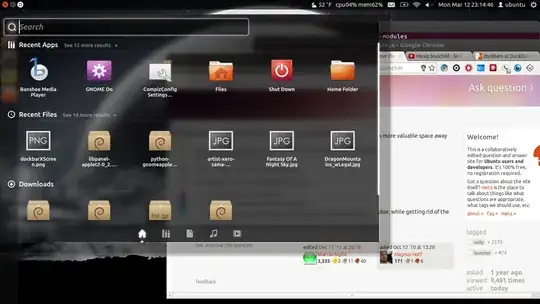

You can do what I did and install a third party dock (I used DockBarX, but that isn't the easiest thing to install by itself), have that replace the Unity launcher bar and then comment out the script for the Launcher and change the shell to have a width of zero.
The end result is DockBarX with the Unity menu when you press the super key, and all of the other unity things. DockBarX can be replaced with any other dock such as tint or docky or etc etc.
https://i.sstatic.net/55Ist.png
https://i.sstatic.net/oJtSF.png
To do this (note: I am running Ubuntu 12.04 so the steps may vary slightly), simply input
gksudo gedit /usr/share/unity-2d/shell/Shell.qml
and edit line 45 as "width: 0"
and
gksudo gedit /usr/share/unity-2d/shell/launcher/Launcher.qml
and add a " /* " at the start of line 28 (possibly earlier) and a " */ " at the end of line 223.
