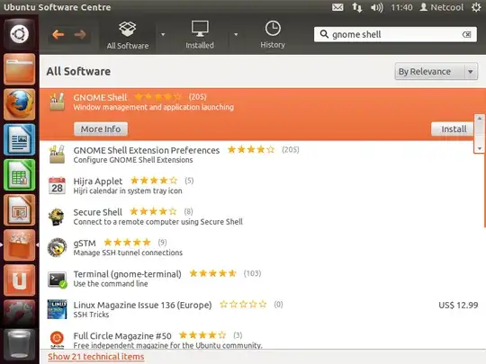

  1. First, start Ubuntu software center
  2. Search for a package called gnome shell: Searching for gnome shell
  3. Install it

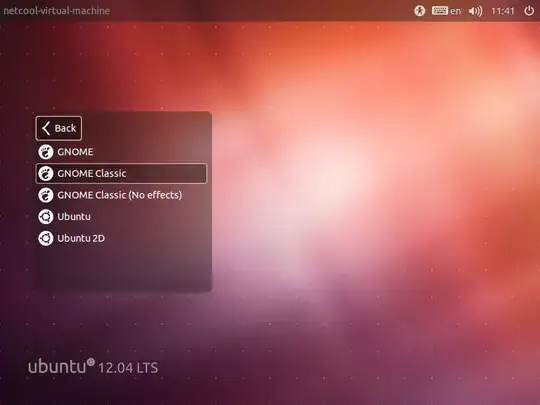

  4. Logout
  5. At the login screen you can now select the icon above and to the right of your username and select Gnome Classic before you logon: Gnome Classic Logon
