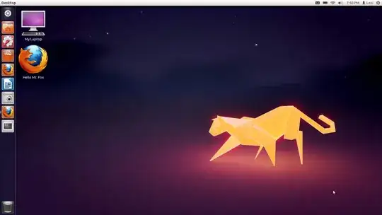

My hard drive was dying so it needed to be replaced. I got a new one and when I got it has this new system on it, but it's very complicated to use. Is there a way I can get it back the the way my old one was?
This new one doesn't seem very customizable at all. One thing that bothers me is that there is no bottom taskbar, so I can't see any windows I have open.

Get to your terminal, and type sudo apt-get install gnome-shell, this will install the Gnome Shell desktop environment, but it will also include Gnome Fallback Session.
Log out, and on the session screen, select the button near your user name, click on "Gnome Fallback", enter password and there you have a fallback session.
Other alternatives might be getting used to Unity, installing Ubuntu 10.04 LTS for a Gnome 2.3 desktop, or alternatives like Cinnamon Desktop environment, which is the most easy alternative for you.
Try googling Cinnamon, there is an article about how to install on webupd8.org
Good luck ;)
You need to give more info, the Desktop Environment you now have is Unity, wich is the default nowadays of Ubuntu, before it was Gnome. If it is Gnome you want you can install it by running the command: sudo apt-get install gnome-shell. Then reboot and on the main screen choose Gnome.
