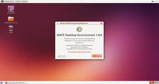

2a. Making Mate
You need to get the Ambiance Theme so open up a terminal and type this in.
cd ~/Downloads
wget http://dl.dropbox.com/u/72782740/debian/ubuntu/ambiance-mate_12.04_all.deb
sudo dpkg -i ambiance-mate_12.04_all.deb
Or download this file, click here to download and install it though Gdebi, Ubuntu Software center, or...

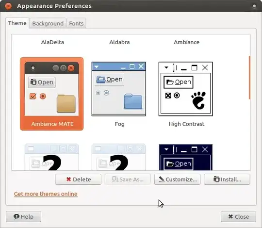

After it is done install, change the Theme to Ambiance MATE so open the Appearance preferences (located under System -> Preferences) and select the Ambiance MATE theme.
This is how It is going to look like

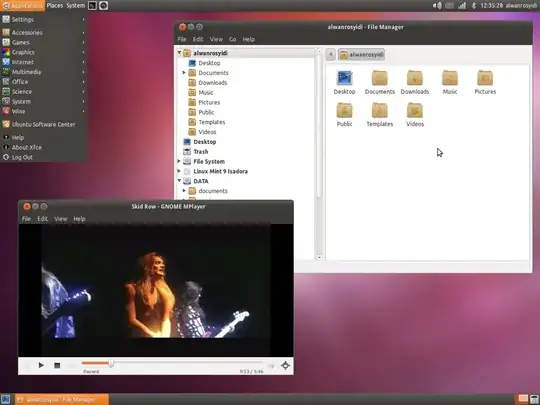

2b. Making XFCE
Making the panels look like Gnome 2
First, Remove the the button panel by right clicking on it and select Delete. Add the Show Desktop, Window Buttons, Workspace Switcher and Trash Applet to the new button panel. Now we are done with the button panel now it is time for the button one so chance the panel size to 24px by right clicking on it and select Panel>Panel Preferences. Rename “File Manager” menu into “Places” by opening the handy terminal and type in sudo nano /usr/share/applications/xfce-settings-manager.desktop find the entry Name and change the entry into this Name=Settings Manager → Name=System save it and close it. Now Right click on the Panel Select Panel Preferences Than Items. Remove all default items and left 8 eight items : Applications Menu, Separator, Notification Area, add a separator between Applications Menu and Notification Area to be Expand by click the item, and click edit item by select Edit the currently selected item button at the bottom of Panel Preferences menu. Then, add two Launcher items and move them to the position after Applications Menu item. Set them to Show Label Instead of Icon, by clicking Edit the currently selected item>Advanced> Show Label Instead of Icon. Now, edit each launcher and add the two main applications. For first launcher, add the Places items by clicking Edit the currently selected item>General>Add new item, search and scroll down to get the Places item. For the second launcher, do the same but put the System item (that we have edited before from the xfce-settings-manager desktop menu).
Now, we have a good looking Gnome 2 panels.

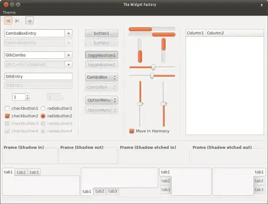

Now We are going to change the theme to Ambiance
Add Ravefinity Project PPA sudo add-apt-repository ppa:ravefinity-project/ppa -y Update package information and install ambiance and radiance themes sudo apt-get update && sudo apt-get install ambiance-xfce-lxde radiance-xfce-lxde Install other colors variations (blue, green, purple, ...): sudo apt-get install ambiance-colors-xfce-lxde radiance-colors-xfce-lxde
After it is done install, change the Theme to Ambiance.

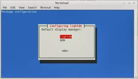

Step 3. Install MDM (Mate Display Manager)
sudo add-apt-repository ppa:noobslab/mint
sudo apt-get update
sudo apt-get install mdm mdm-themes
During the installation you will get a window asking you to choose your default DM, like the one in the print screen. Choose MDM.

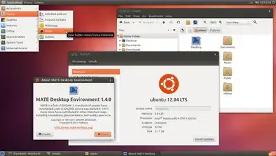

Ubuntu 10.04 used the GNOME 2.4 Desktop and 12.04 uses the Unity Desktop.
I would suggest you check out MATE as a solution to making Ubuntu 12.04 feel like Ubuntu 10.04
Add ONE of the following repos to /etc/apt/sources.list via the following command:
sudo add-apt-repository "deb http://packages.mate-desktop.org/repo/ubuntu precise main"
sudo add-apt-repository "deb http://repo.mate-desktop.org/ubuntu precise main"
sudo add-apt-repository "deb http://mirror1.mate-desktop.org/ubuntu precise main"
then run the following
sudo apt-get update
sudo apt-get --yes --quiet --allow-unauthenticated install mate-archive-keyring
sudo apt-get update
# this installs base packages
sudo apt-get install mate-core
# this installs more packages
sudo apt-get install mate-desktop-environment
finally log out and then select "MATE Desktop" from the session menu and login
