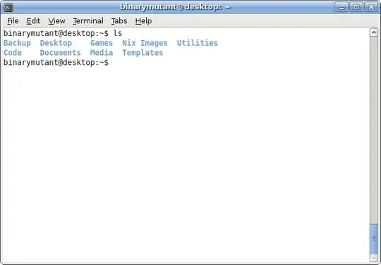

What is it:
The terminal is an interface in which you can type and execute text based commands.
terminal screenshot

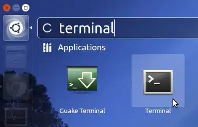

How do I open a terminal:
  • Open the Dash (Super Key) or Applications and type terminal
  • Use the keyboard shortcut by pressing Ctrl+Alt+T.

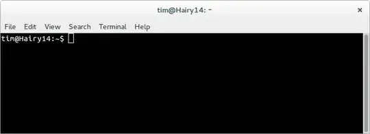

The terminal (also known as console) is an application in which you can execute commands directly. It looks like:
gnome-terminal screenshot
