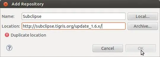

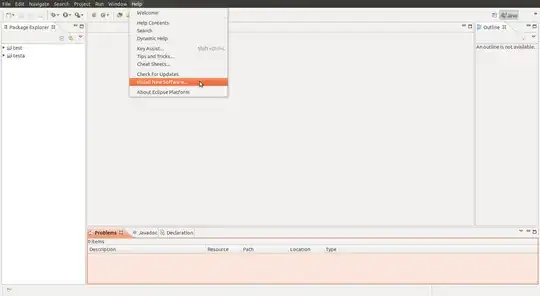

I went to "Help->Install new software"
Added the matching site for svn integration. Make it match the version of libsvn.

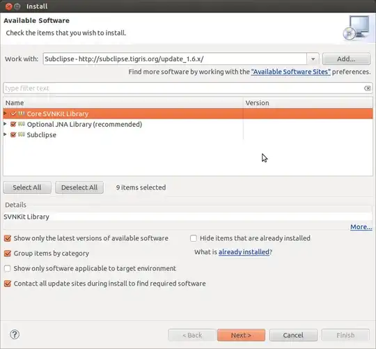

Installed the full load of packages
