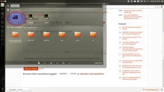

It means you need to go to command line and start typing commands (or copy/paste them)4
Hit the super key to open Dash and type "terminal"
and you will see something similar to this:
and you can start typing commands.

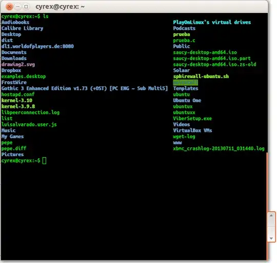

They refer to what is commonly known as THE TERMINAL!! which looks somethings like this:
This terminal which is opened in Ubuntu by pressing CTRL+ALT+T is the opposite of a GUI Which is a Graphical User Interface and it normally does not use a pointing devices like a mouse. It is commonly used with only the keyboard or a keyboard like interface. You type in the terminal what is called a command to tell the terminal to do something and it replies with an output depending on what you told the terminal. In the image above I used the command ls to tell the terminal to "List" all the files in my current directory.
If I used the cd which is short for "Change Directory" I would change my current directory to another directory that I had added after the cd command. For example cd Downloads would take me to the Downloads directory.
