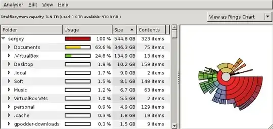

Since you don't specifically mention you need a terminal-based solution, I think baobab a.k.a. Disk Usage Analyzer is missing from the list.
It is installed in Ubuntu by default and does exactly what you want in a nice graphical UI with the ability to drill down the directory hierarchy.
Apart from displaying a list of directories with their sizes, it is also showing a rings or treemap chart of filesystem usage, which is extremely useful for visualising the directories which take up the most space.
baobab the Disk Usage Analyzer
