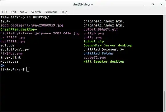

Simply, you open a Terminal and type (or copy / paste) the command in, then press Enter. In the image, I've run the command ls Desktop/ which will list all files on my desktop. Note that to paste you press Ctrl + Shift + V in the terminal.
By default you open the terminal by pressing Ctrl + Alt + T, or opening the Dash and searching for "Terminal".

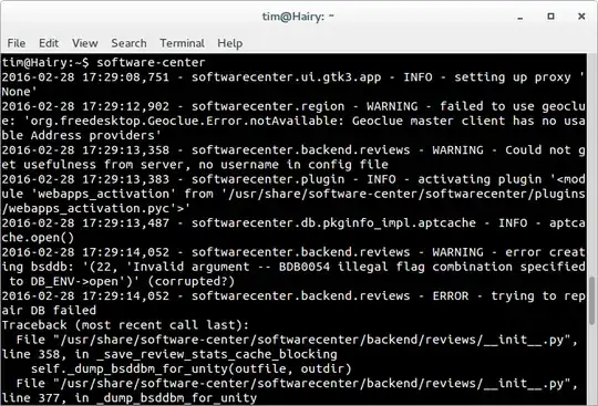

The terminal can also launch GUI programs. This can have the advantage of viewing the output the program gives - for example running software-centre looks like this:

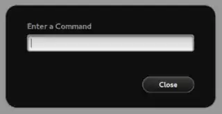

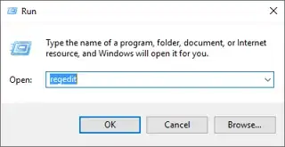

Press Alt + F2, and a "Run Dialouge" appears - a bit like the run window on Windows:
Ubuntu:                                                                                    Windows:
You can type any command into here, and it will run it!
