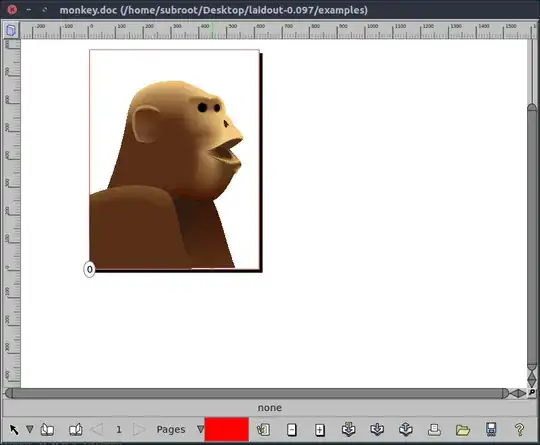

This should open a Laidout window where you can create new documents or open existing ones. The screenshot below I have opened one of the example files, monkey.doc
Laidout window
