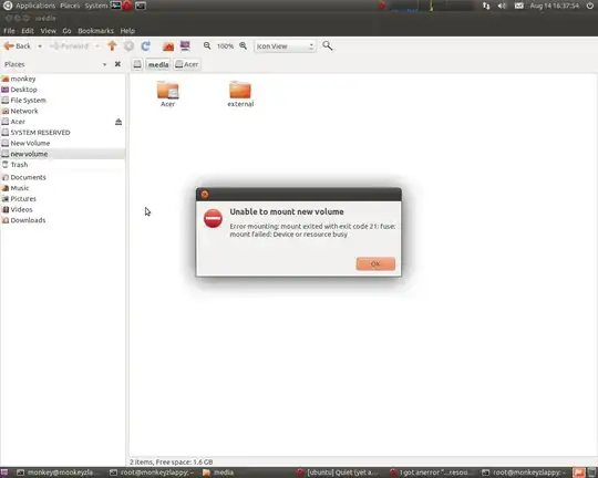

While trying to mount my hard drive to copy all the necessary data from my broken drive to this one, I got an error saying:
# mount -t ntfs /dev/sda1 /mnt/dominik/
fuse: mount failed: Device or resource busy
This is my fdisk -l if that helps.

And just to let you know I can see this partition in Computer but when I try to access it I get this error

I suspect that /dev/sda1 is already mounted under /media/ACER. Nautilus automatically mounts partitions when selecting it on the left side. You cannot mount a partition multiple times (leaving out --bind mounts).
