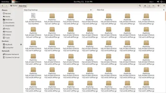

I need to remove old backups from my SSD and my external (Western Digital) hard drive because they're taking up so much space.
Except for the most recent files/package, can I simply delete the old backups (I would think not), or do I need to actually uninstall them from my SSD and the external drive?
Looking at the file name of the backups, I don't know or understand what any of them are, so I don't know what can be removed safely, and what should remain.

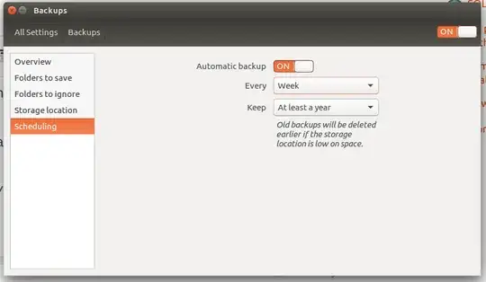

Using the GUI
The GUI doesn't have much options, the most you can do is go to the Scheduling tab and set the Keep setting to either "At least a year" or "At least 6 months". The application will manage storage space, by deleting old backups when it finds that the storage is low on space.

If you delete ~/deja-dup and its content you will only use past backups. If you feel that you don't need them any longer (or not as much as the storage space they occupy), you can delete them safely.
I don't know about the files on the external drive because I don't know their names or what they are. If they have very similar names to the files in ~/deja-dup, the same as above applies.
