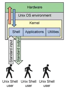

Shell
Basically an application for running commands.
ShellShell
