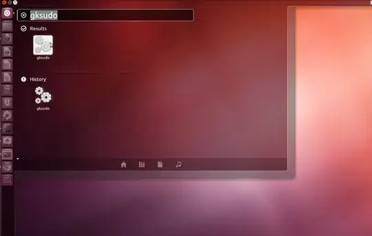

If you don't want to use a terminal, you can invoke a GUI program as root thus (this example is for Gedit):
  1. Hit Alt+F2 to bring up the Run dialog.
  2. Type gksudo followed by the executable name of your program (which might be different from the name displayed by the GUI). For example:
    gksudo gedit
  3. Hit Enter.
10
I can't think of a case where root would get permission denied.

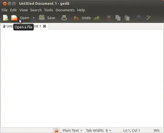

In 12.04 you can do it like this: alt+f2 and enter gksudo in the box that appears like this:
F2 dialogue
You get a box like this and enter gedit and click ok:
Type gedit in Run dialogue
Click Open:
Open tab inside gedit

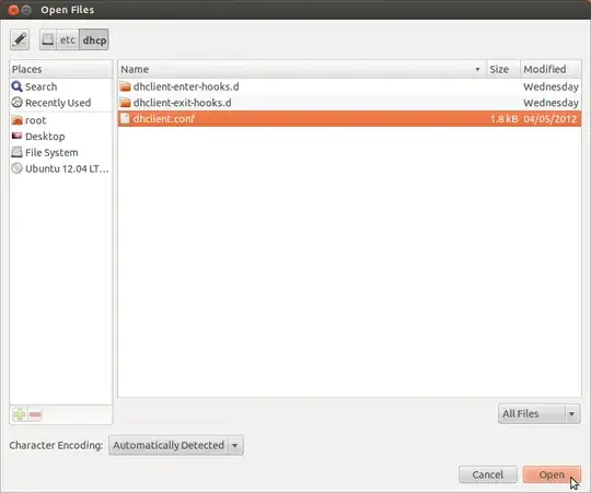

Just browse to the file:
open files dialogue
Done

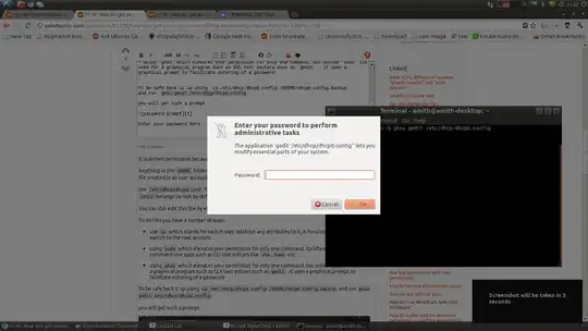

To be safe back it up using cp /etc/dhcp/dhcpd.config /$HOME/dhcpd.config.backup and run gksu gedit /etc/dhcp/dhcpd.config
Replace gedit with the editor of your choice
you will get a prompt like this
password prompt
Enter your password here.
A new window opens and you can edit your config there.
In case something goes wrong you can restore it from your backup in the home folder.
