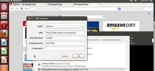

After performing that command, and setting up the sources exactly like in your screen-shot, do:
sudo apt-get update
sudo apt-get install opera
(note there are some random warnings, but nothing that affects the install or software center operations)
And for the removal (just in case): What is the correct way to completely remove an application?
So in summary:

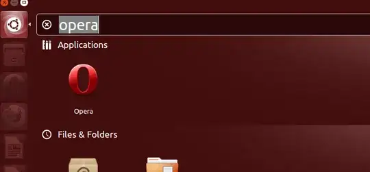

  • Add repository enter image description here
  • Add key with apt-key
  • Install in terminal with apt-get
  • Search in dash enter image description here
