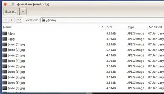

I had the same issue with rar-file that contained names with Cyrillic letters. I was able to fix it by reinstalling unrar as it is suggested here:
$ sudo apt-get remove rar
$ sudo apt-get remove unrar
$ sudo apt-get install unrar
It turned out that by default the open source version of rar & unrar utilities is installed in Ubuntu: "unrar 0.0.1 Copyright (C) 2004 Ben Asselstine, Jeroen Dekkers". This version does not handle non-ascii symbols well.
After reinstalling the unrar the actual version of it installed from "restricted" (proprietary software) repository (note that this should be enabled in your update settings): "UNRAR 5.40 freeware Copyright (c) 1993-2016 Alexander Roshal"
This version handles Unicode symbols, at least it worked for me with Cyrillic letters.
Note that removing open source version of rar/unrar also fixed an issue with GUI software: Rar archive with Cyrillic letters
