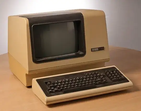

This is a real terminal, as larsmans pointed out:
