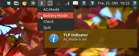

TLP Indicator for Unity A Unity Indicator created to comfortably switch between AC and BAT Modes. Use it at your own risk. Download here: indicator-TLP.py

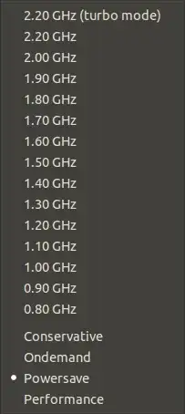

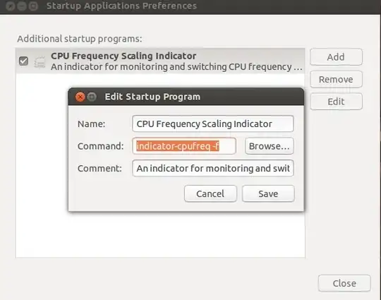

Tweak your CPU frequency with indicator-cpufreq
Installation
indicator-cpufreq will help you change your CPU frequency on the go:
sudo apt-get install indicator-cpufreq
Go to Dash > search for Startup > edit indicator-cpufreq add -f or copy paste the following command:
indicator-cpufreq -f
Screenshot
screenshot
With the indicator you will be able to monitor your current CPU frequency & can change CPU frequency
Changing CPU frequency
Click on indicator

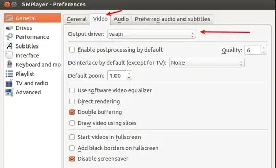

SMPLAYER
Its in Option tab > Preferences, on the Video tab > General Video > Output driver set the video output driver to "vaapi":
screenshot

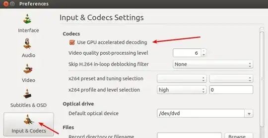

VLC
Its in Tools > Preferences > Input & Codecs > Enable Use GPU Accelerated decoding

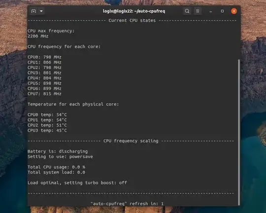

I'd like to add auto-cpufreq to the list. It's a new automatic CPU speed and power optimization tool for Linux laptops using Intel CPUs. Support for AMD CPUs is being worked on.
This command line tool automatically changes the CPU frequency scaling, governor (switches between performance and powersave, these being the only 2 modes supported by the nowadays default intel_pstate scaling driver) and turbo boost status based on various information gathered from your computer, like the battery state, CPU usage and system load. (source: Linux Uprising)
The installation instructions below come from its Github page:
Install dependencies:
sudo apt install git python3-dev python3-pip python3-distro python3-psutil python3-click python3-power -y
On Ubuntu versions older than 19.10:
pip3 install --upgrade psutil click distro power
Grab auto-cpufreq from Git:
git clone https://github.com/AdnanHodzic/auto-cpufreq.git
Run auto-cpufreq
cd auto-cpufreq
sudo python3 auto-cpufreq.py --live
--live enables auto-cpufreq so you can see how your system behaves with the new settings, but it doesn't make these settings permanent.
To make it permanent, use the --install option (so the changes persist across reboots; this installs the auto-cpufreq daemon and systemd service):
sudo python3 auto-cpufreq.py --install
