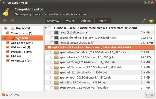

For GUI based
Ubuntu Tweak
sudo add-apt-repository ppa:tualatrix/next
sudo apt-get update
sudo apt-get install ubuntu-tweak
and then run ubuntu-tweak and there is an option called Janitor which is used for spring cleaning as seen in the picture:

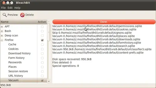

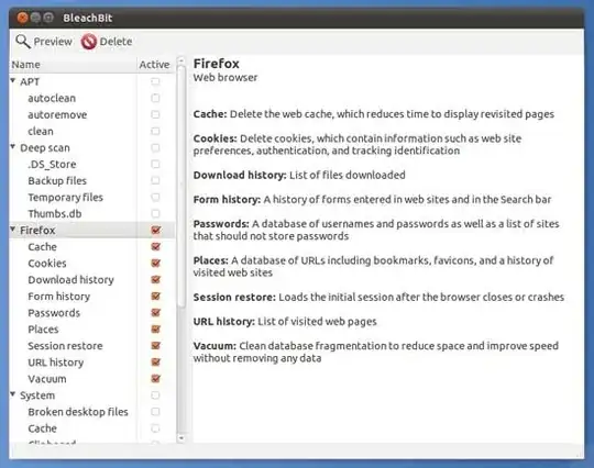

Lastly there is a GUI Tool (Thank Uri in the comment for this. I forgot):
BleachBit
BleachBit is an advance cleaning utility for Ubuntu (Similar to CCleaner) and other distros that really, REALLY cleans the system. You can find it in the Software Center just by searching for bleach. What makes it different from the Ubuntu Tweak is that it searches for many common folders that many apps use to store cache/temp files. Apart from that improves a little bit the performance of browsers (since it cleans them out too) and libreoffice. There are a lot of more stuff BleachBit does but go to the site for more info. +1 Uri for the reminder.

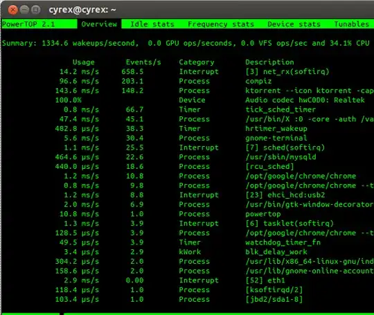

For battery performance, it is known that the following tools do help:
Powertop
It can save several minutes/hours of battery usage, increasing life of battery and performance of it.
To install: sudo apt-get install powertop
To run: sudo powertop

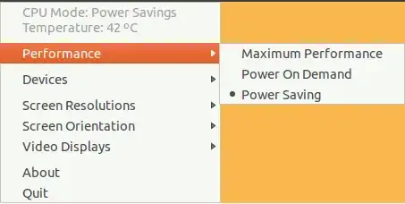

Jupiter
(NOT available/needed since 13.04) Recommended reading Is there a power saving application similar to Jupiter? It manages much better the battery usage and it gives longer battery time.
sudo add-apt-repository ppa:webupd8team/jupiter
sudo apt-get update
sudo apt-get install jupiter
To run: Type jupiter in Dash or use the Jupiter Applet icon in the top panel.

actually, it does need cleaning up, quite often in my opinion, the best app for that is bleach bit, its a little like the famous CCleaner on windows, Bleachbit is in the software centre
cleans up your firefox cache, apt cache, empties trash etc etc, it should come peinstalled in ubuntu to be honest, if you have been running your system a while, you could potentally free up hundreds of MBs on first run of bleachbit
Bleachbit

hello IMHO ubuntu does need that too with time pass you install/remove things lets say you ll have some config files that you dont need anymore beside that some orphane packages of course some thumbs ... , you can try bleachbit
