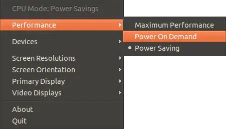

  • Install CPUFreq
    sudo apt-get install indicator-cpufreq
You will then be able to click on the icon to the right of the keyboard icon in this screenshot below (indicator bar):
And this should open up a menu like below:

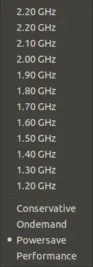

The lower your processor speeds the less power it will consume, so either go with Powersave or put it on the minimum, this reduces battery power consumption especially well if you have a multi-core CPU.

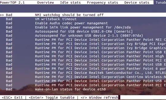

  • Install powertop: sudo apt-get install powertop
You run the app by typing in sudo powertop in the terminal and you use the arrow keys to go the far right column entitled Tunables, you should see something like this:
Using the arrow keys select each of the "Bad" settings and set them to "Good" by pressing enter, this should ensure your computer is using your battery in an optimal way.

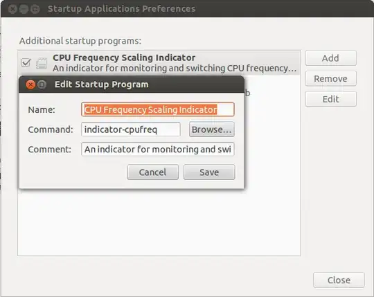

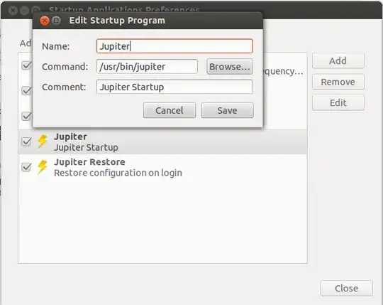

Set Jupiter and CPUFreq on startup
Normally Jupiter and CPUFreq should start up automatically next time you reboot but if they don't all you have to do is go into start-up applications and type in the following:
  • For jupiter
  • For CPUFreq
Obviously you can change the names and comments of the start-up programs to whatever you want as long as the command stays the same.
