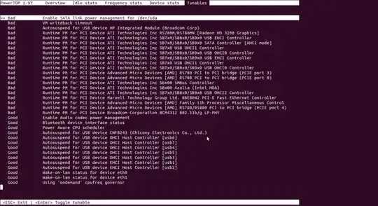

I'm on a Compaq 615 and it's fan is loud. Not much you can do about that but I'm trying to keep the CPU/GPU as cool as possible. This is what Powertop has to say:
PowerTOP 1.97 - Overview - Idle stats - Frequency stats - Device stats - Tunables
If I change all of them to "good", the changes don't survive a reboot.
I added the line to the "grub"-file as suggested here
How do I make the Powertop suggested "Tunables" permanent?

If you change all of them to good anyway, you could simply use the command
sudo powertop --auto-tune
Call powertop auto-tune automatically at boot time

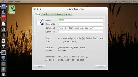

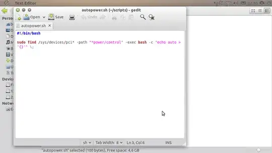

As a semi automatic solution I created a launcher:
the script is as follows:
Is there a way to prevent asking for my password?
