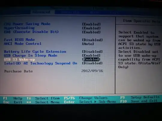

I solved it going into the BIOS (F2 key when booting up) and activating "USB S3 Wake_up" option under the Advanced tab. enter image description here
Hope this works for you!
