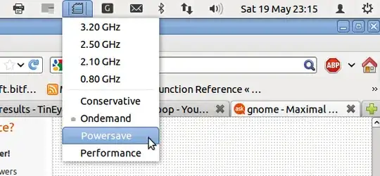

  • Lock the CPU to the lowest possible clock rate by using the powersave governor:
sudo apt-get install indicator-cpufreq
