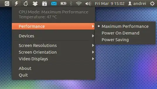

You could install Jupiter (http://www.jupiterapplet.org/)
Which adds this this features to your system and allow you to control it using an indicator
Just add the PPA ppa:webupd8team/jupiter to your system using this command
sudo add-apt-repository ppa:webupd8team/jupiter
Update your reposites and install it using these command(s)
sudo apt-get update && sudo apt-get install jupiter
and you are good to go

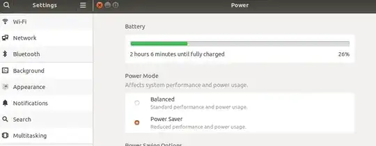

It seems like this is now a feature in Ubuntu 22.04.
