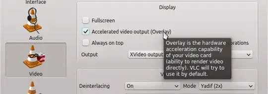

VLC is a different story, but it's being built with the --enable-libva build flag in Ubuntu (as shown by the apt-get source vlc). This means it should just work by enabling it in the configuration:
Or, manually, on the command line:
vlc --ffmpeg-hw -v
