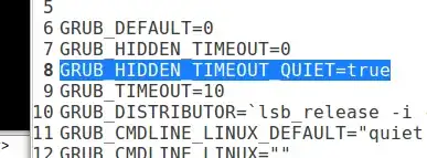

You need to edit the file at /etc/default/grub to prevent showing the grub menu.
By default, the entries in that files look like this.
GRUB_DEFAULT=0
#GRUB_HIDDEN_TIMEOUT=0
GRUB_HIDDEN_TIMEOUT_QUIET=false
GRUB_TIMEOUT=10
GRUB_DISTRIBUTOR=`lsb_release -i -s 2> /dev/null || echo Debian`
GRUB_CMDLINE_LINUX_DEFAULT="quiet splash"
GRUB_CMDLINE_LINUX=""
  • Remove the # mark from second line, and
  • Change the line GRUB_HIDDEN_TIMEOUT_QUIET=false to GRUB_HIDDEN_TIMEOUT_QUIET=true.
After changes, the required portion of the file will look like this
GRUB_DEFAULT=0
GRUB_TIMEOUT=10
  • Then run sudo update-grub command in the terminal, and reboot to see the result.
