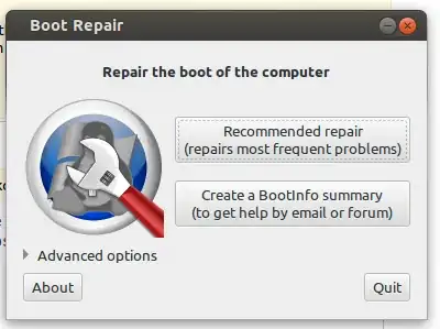

Install the boot-repair program, See this link on how to install boot-repair and follow the following steps.
boot-repair welcome
Select the "Advanced options" in the bottom

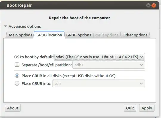

GRUB Location
Now select on the "GRUB Location" tab

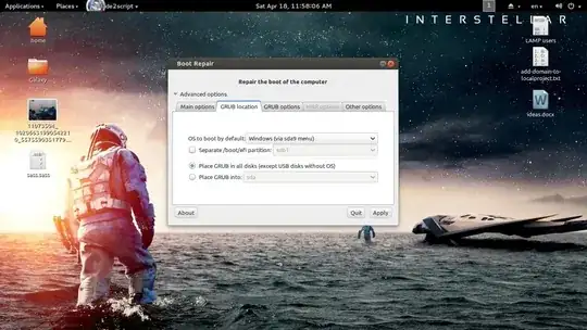

OS to boot by default
Now change the "OS to boot by default" field to Windows.
Hope this will fix the problem on a restart. Kudos :)
