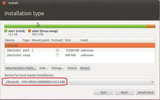

  • Install Ubuntu on that partition & install GRUB on 2nd disk's MBR not on first disk's MBR. Be careful here. See below image (just for demo purpose), you need to do everything in (probably) sdb.
  • You select your already created sdb partition, edit, assign mount point /, and file system type ext4
  • Select boot loader location as sdb , not sda (see red colored section)
bootloaderLocation
