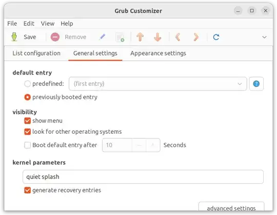

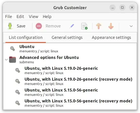

You can use an application called Grub Customizer. It is much more easier.
You can install it by:
sudo add-apt-repository ppa:danielrichter2007/grub-customizer
sudo apt-get update
sudo apt-get install grub-customizer
If you are getting errors adding ppa, it is possible that grub-customizer is already included. Try installing without adding the ppa.
There is an How-To Geek article about it, How to Configure the Linux GRUB 2 Boot Menu the Easy Way. Also, there is a solved thread on the Ubuntu Forums, Change boot order in GRUB 2 that mentions this tool.
Here are some screen shots of this software:
Screenshot
Screenshot

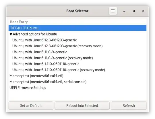

You can use Boot Selector, a gui tool for easily setting default boot entry in grub: https://github.com/mfat/bootselector
bootselector screenshot
mFat
