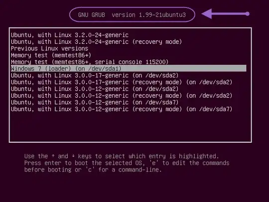

Please check the version of GRUB used on your computer
According to this section of the Ubuntu GRUB documentation, you can check the current version installed on your system ... from the command line by opening a Terminal and entering the following:
  grub-install -v
Grub 2 should display a version number of 1.96 or later. Grub Legacy is version 0.97.
Please also take a look at the version information displayed on your GRUB boot menu. It's pretty easy to find, but I provided an image to illustrate anyway. :-)
