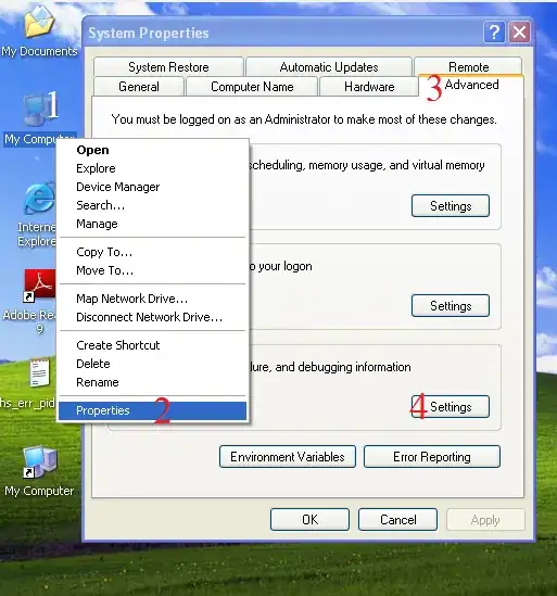

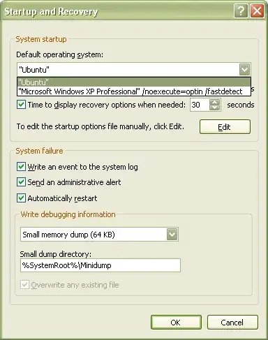

Click setting and select wubi as default operating system from drop-down menu. Click OK.
