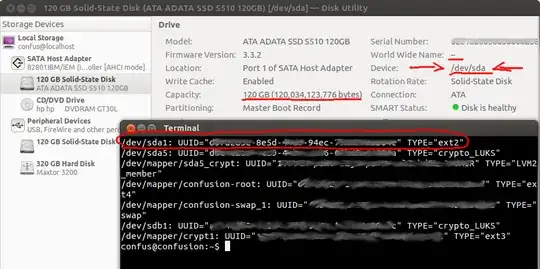

Finding the UUID:
Disk Utility and blkid
Open Disk Utility and identify the proper partitions by their size (e.g. 120 GB), file system (e.g. ntfs) and name. Note their "Device:" file (e.g. /dev/sdb1). Instead you can run the following command in a Terminal such as gnome-terminal:
sudo fdisk -l
You can find out the UUID of your partitions by running sudo blkid in shell. The output looks somewhat like this:
confus@confusion:~$ sudo blkid
[sudo] password for confus:
/dev/sda1: LABEL="boot" UUID="cc425c68-704f-4836-9123-bbb3aea64471" TYPE="ext2"
/dev/sda2: UUID="1c8b1489-e111-481c-89f2-743203c3ee7d" TYPE="crypto_LUKS"
/dev/sda3: UUID="7258CB9858CB598D" TYPE="ntfs"
/dev/sda4: LABEL="HP_TOOLS" UUID="1405-0A4C" TYPE="vfat"
/dev/mapper/lukslvm: UUID="xZSNtR-MocS-dLMk-vOWa-Ay65-wS9b-GqaNhV" TYPE="LVM2_member"
/dev/mapper/vgubuntu-swap: UUID="f415f3b9-4e4d-48b1-99c2-605e16532f9e" TYPE="swap"
/dev/mapper/vgubuntu-root: UUID="62a862b4-e6c8-4efd-90b5-55eab8e83e39" TYPE="ext4"
The correct UUID will have the proper device file in front of it and TYPE="ntfs" after. So for me the UUID is "7258CB9858CB598D". For you this number will be different. Also I have only one NTFS partition. Subitute my UUID in the lines you add to fstab by the one you found this way.

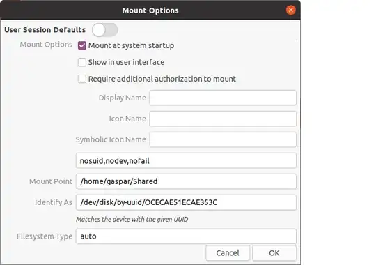

Ubuntu 20.04 and later
  • Open nautilus and create a new folder, I suggest in the home folder.
  • Open the Disks application.
  • Select the partition you want to automount and then click on Additional partition options of the partition -> Edit Mount Options.
  • Select the Mount at system startup checkbox and unselect the other two options.
  • In Mount Point set the path to the folder you've created, in my case it is Shared.
  • Click the OK button and restart the computer.

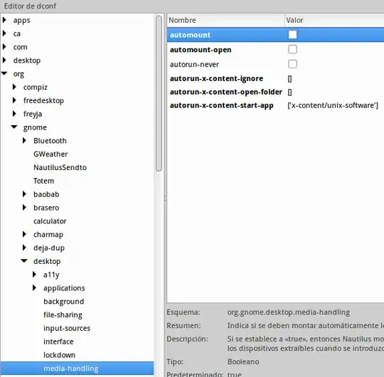

To enable or disable automount open a terminal and type dconf-editor followed by the [Enter] key.
Browse to
org.gnome.desktop.media-handling
The automount key controls whether to automatically mount media. If set to true, then Nautilus will automatically mount media such as user-visible hard disks and removable media on start-up and media insertion.
There is another key
org.gnome.desktop.media-handling.automount-open
This controls whether to automatically open a folder for automounted media.
If set to true, then Nautilus will automatically open a folder when media is automounted. This only applies to media where no known x-content/* type was detected; for media where a known x-content type is detected, the user configurable action will be taken instead.
dconf-editor disabling automount
Source: Ubuntu Documentation
