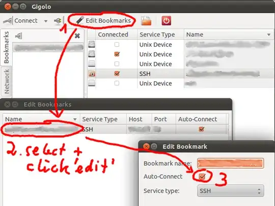

If you want even less work (=autoconnect) and a graphical user interface, you might want to check out Gigolo Install gigolo. It has the capability of auto-mounting a bookmark, whenever the bookmarked filesystem is present. You might want to check that out.
sudo apt-get install gigolo   # or use the install link above
Run gigolo. There is an option in the preferences that puts it into autostart and another to activate the tray icon. Check both. Then add your bookmark.
Here is a screenshot:

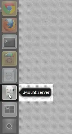

I mount a folder the exact same way, what i did was create a custom launcher that points to a .sh file that contains the command. Just make sure the file has execution permission and you're good to go.
I just click on the launcher:
