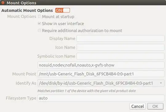

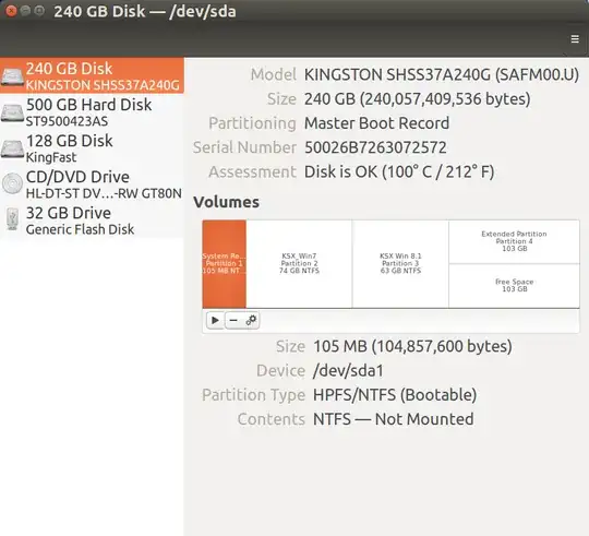

Basic GUI steps
The easiest way of auto-mounting drives is using Disks utility accessed from Dash (first option on launcher):
Disks GUI
Click on a drive, click on a partition and then click on the nearly invisible gears icon below it after the "play" and + icons. Then select Edit Mount Options... from the drop-down menu:
Disks Generic Flash Drive
Here you can hide the partition in Nautilus, prevent auto-mounting or allow auto-mounting (but it doesn't update /etc/fstab). In this example the "Generic Flash Disk" is selected and you can see by default it's not auto-mounted.
