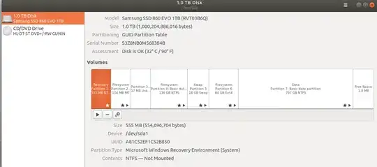

So I started with a completely blank 1TB SSD yesterday, installed windows first, then created a 80 GB partition for ubuntu and a 16 GB Swap partition. Then went back into windows and filled the rest of the drive with an NTFS partition for shared file space between the two OSs. With the extra recovery / boot paritions windows makes this is what it looks like:
Partition Schema
Partition 4 is Windows C:\ Partition 6 is / Partition 7 is Windows D:\ (shared data)

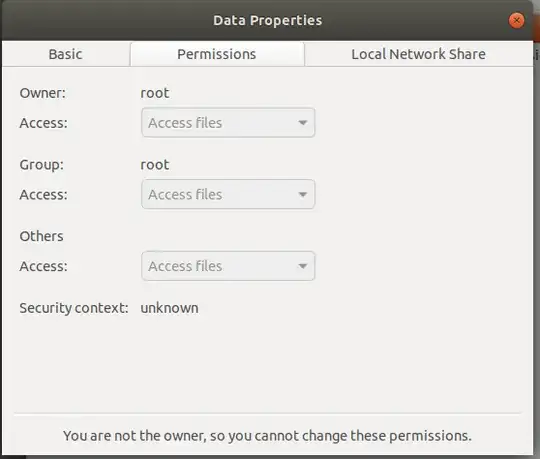

Data properties

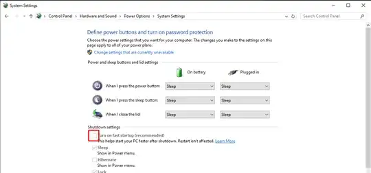

First I turned off fast-start from the power settings:Fast Start Power Settings
