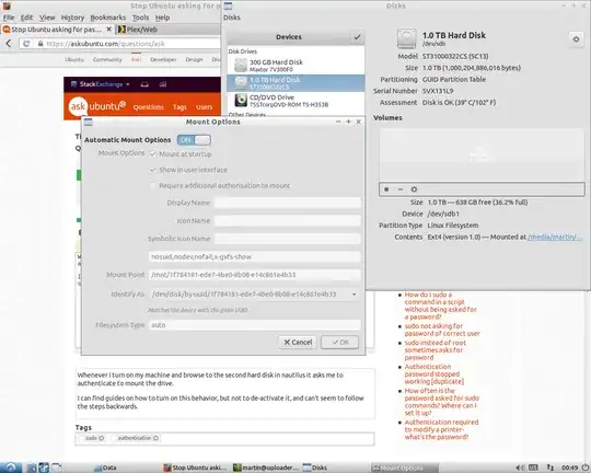

Whenever I turn on my machine and browse to the second hard disk in nautilus it asks me to authenticate to mount the drive.
I can find guides on how to turn on this behavior, but not to de-activate it, and can't seem to follow the steps backwards.
The disk is automounted and below is a screenshot, please let me know what other information you need
disk manager details

Add "user" to your mount options to allow any user to mount the partition. Your mount options in your image are just above the "Mount Point" label, on an unlabeled line starting "nosuid,... You also seem to have something inconsistent on the location of the mount. Did you want it under /mnt or under /media? The /etc/fstab file is the location for what typically gets automounted, but you seem to have a GUI to edit it. A second mount mechanism is through your desktop and typically mounts things under /media//. Your image also seems to indicate a /dev/sdb1 mount using this mechanism, but I'm not sure that's the same as the uuid identified device.
