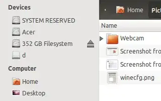

This is through Nautilus, the file manager. You should be able to see an icon for this partition in the left panel of Nautilus under Devices.
Clicking on this icon will mount the partition. The mount point will probably be different from the one you created, but this is the easiest way to quickly access a file from that partition. However, if you do this and then try to mount same partition using the command:
sudo mount /dev/sda5/ /media/alexandru/Hard/
Then you will get the error you got, as the partition is already mounted on another folder. Conversely, if you mount the partition using the command first, you won't see the icon for the partition in Nautilus.
