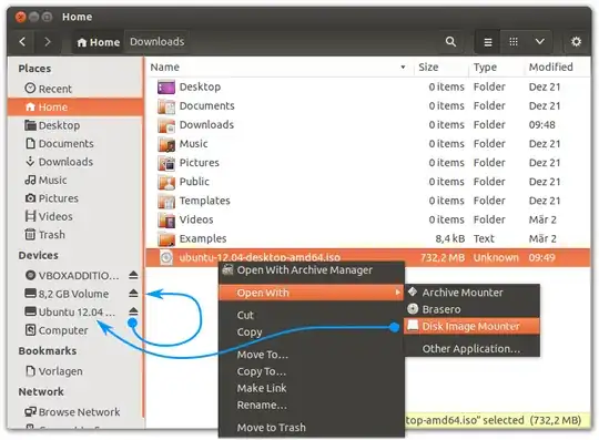

  1. Mount the .iso-file and copy the contents over to your USB drive. Press Ctrl+H in Nautilus to display and copy hidden files as well.
    nautilus showing Disk Image Mounter in context menu when .iso-file is selected

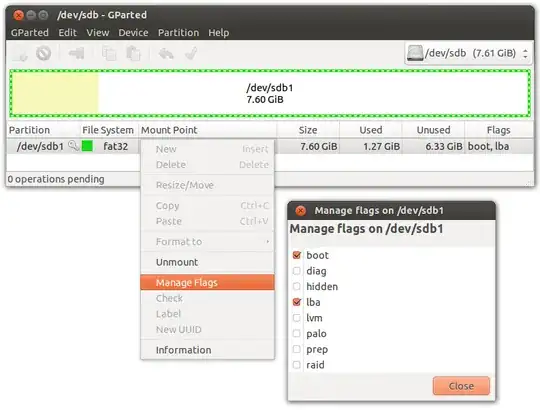

  2. Add the boot flag via GParted.
    GParted showing how to manage partition flags
