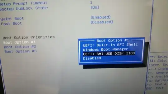

  1. I have tried using dd and Ubuntu startup disk maker to make a usb installer, but even I choose boot from usb, my computer still directly boot into win10. I don't know why.
  2. I have also tried build a uefi bootable usb by the accepted answer (1st command line method) in this link, but it did not work.
  3. I have also tried to build a uefi usb under win10 by following this link, and I also disabled the secure boot option in bios, however system just won't boot from usb.

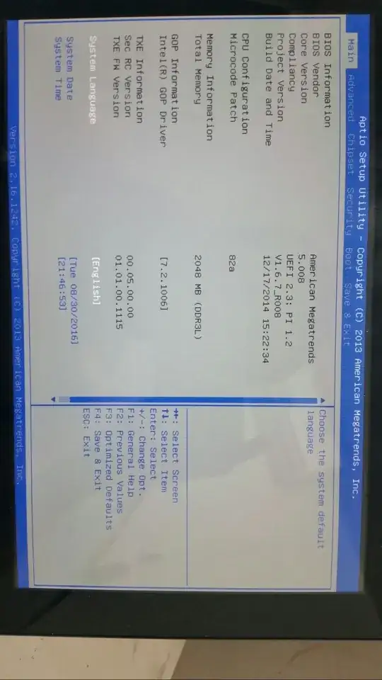

  4. It seem that I have a 32bit UEFI(I am not sure though, the reasoning is that my processor is intel atom z3736, but my win10 is 32bit, someone know how to check this explicitly please tell me), and it is quite troublesome to deal with 32bit UEFI, according to this link.

the bios info:
According to many articles, install ubuntu on a UEFI 32 bit system with 64bit cpu is troublesome, including the official sites, see the first item.
However, Debian is a savior and many people yet don't know this, including me. Salute to their developers! The latest Debian support 32bit & 64bit UEFI very well. You can see these two posts: first by intel and second by Debian developer.
To install it, you can download the latest iso image here, and make an usb disk following the documentation-4.3.1. Other method using dd or ubuntu startup disk creator should also work (I didn't try). After this, you need to choose to boot from usb.
