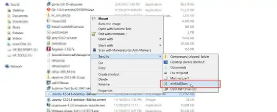

Windows..
gui..
You can use winMD5sum in Windows to check file hashes.
Open Windows Explorer and locate your CD image. Right click on it and select "Send to.." then click "winMD5sum".
WinMD5sum will automatically calculate the hash and display it.
Paste the hash for your release (which you got from Ubuntu Hashes) into the "Compare" box and click "Compare". A popup dialog should confirm that the hashes match.
